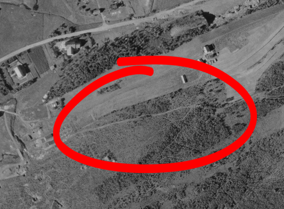

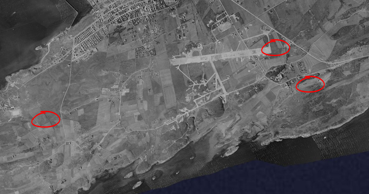

- Oversikt.jpg (311.16 KiB) Viewed 18778 times
- Flusi Jensvold.jpg (183.04 KiB) Viewed 18778 times
- Kart Jensvoll.jpg (316.06 KiB) Viewed 18778 times

Hi Thomas!
Very kind of you!
As you can see, the masts of "Flusi 1" are direct next to the hut and
there are six of them.
After the book of Fritz Trenkle "Die deutschen Funkpeil- und Horch-
Verfahren bis 1945", this is a indicator for a shortwave-Adcock of the
"A-70"-series, because only the shortwave-adcocks "A-70 b", "A-70 h"
and "A-70 k" had six masts.
The diagonal base (from mast to mast) of the "A-70 b" was 9,6 m, for
"h" and "k" 7,5 m.
When you take a really close look at the masts at "Norge i Bilder" and
change to the nowadays picture, it seems to me, that the foundation
of the masts are still there. ???
So "Flusi 2" at Jensvold (or is it Jensvoll?) should have been the longwave-
Adcock. All Luftwaffe longwave-Adcocks had just four masts.
The Luftwaffe A-40/A-50/A-60-series for longwave had a base between
14 and 60 m.
Good luck for your search!
Rolf
Very kind of you!
"h" and "k" 7,5 m.
14 and 60 m.
Rolf

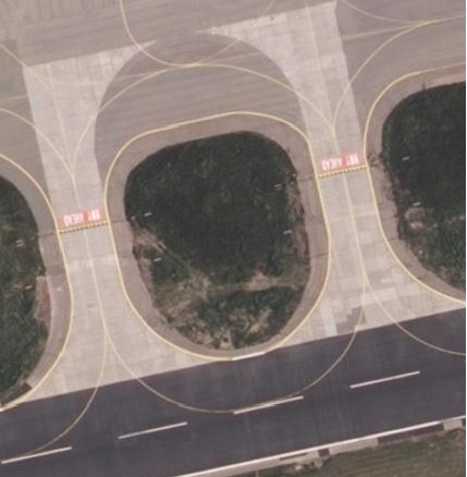

Hei Rolf
Thanks for great information. This is something I don't know so much about.
I can ensure you that there are no remains og the Foundation for "Flusi 1".
The hole area has been turned up side down when the airport was built.
On the picture below you can see four foundation, and that's for runway marking signs.
I'll be back with some information about "Flusi 2" in a few days.
The correct name is "Jensvold"
Rgds
Rgds

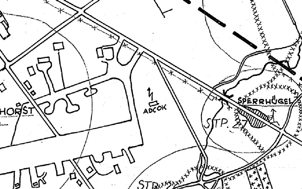

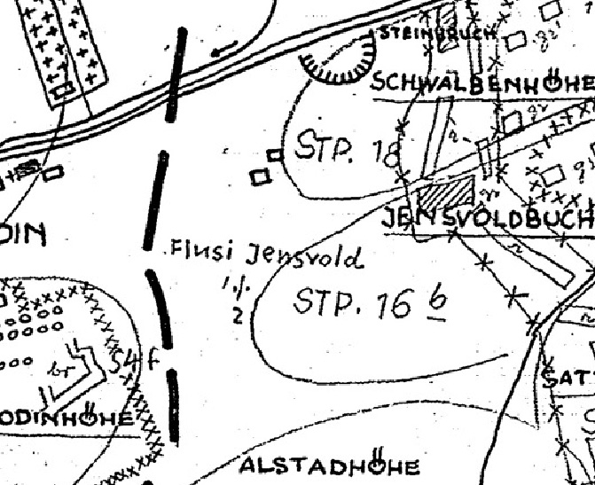

Hi!
It was very nice by the Germans to paint their numbers of "light maschine-guns" onto the
map, which they had to protect their "Flusi-stuff".
West of the airfield there was just one. That's the reason, I called it "Flusi 1". At "Flusi
Jensvold" there were two light MG. This was the reason I called it "Flusi 2".
Just that you don't mix it up...
Best wishes and greetings to Norway
Rolf
Rolf

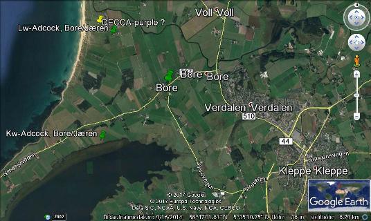

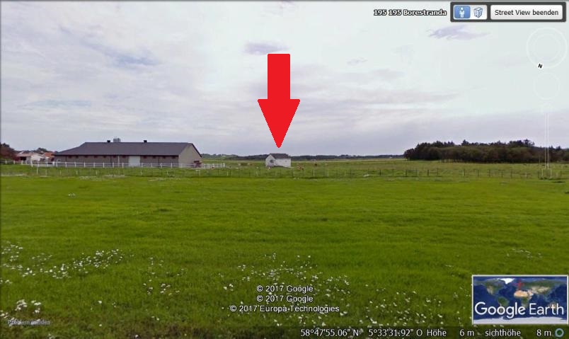

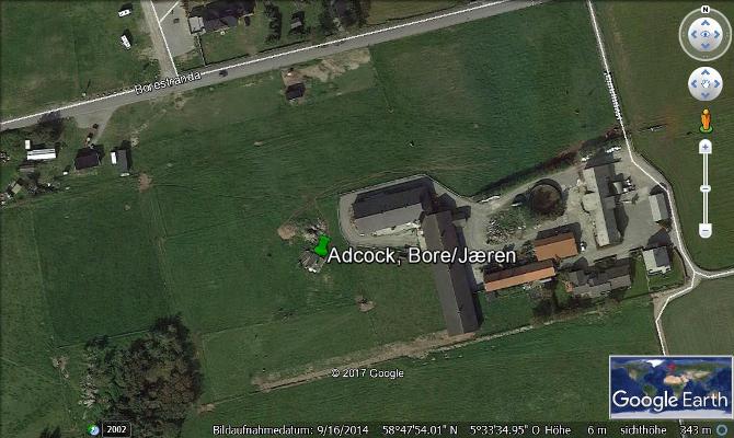

Hi!
After I read the notes of Erik E and TØ about the DF at Bore/Hodne,
I took a look at this area at Norgeibilder.
A list of Adcocks in Norway says, the Germans had in Bore-area a
Shortwave-DF and a Longwave-DF both for "Flugsicherung" (air
traffic control).
I found the shortwave-DF-hut in Hodne-area quite easy at the pictures
of 1960 (Thank you, TØ, for the information about Hodne!).
North of the position, I found a "antenna" which looks to me like a
longwave-Adcock. The main hut is still there today. 360 m northwest of the "LW-Adcock" was a huge single mast in 1960.
I'm not sure, but as far as I know, there was a DECCA-station in this
area for navigation in post-war-times. I think this mast was the DECCA-
station. My question:
Was the large "four-mast-post" a German-longwave-Adcock, which was used by Norway after the war
or does this post belong to the "DECCA-mast"?
Source of the b/w-pictures: http://www.norgeibilder.no/
Thanks in advice
Best wishes
Rolf

The installation with the four masts certainly looks like a LW-Adcock.
bregds
SES
bregds
SES

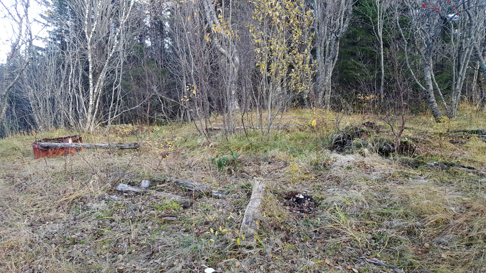

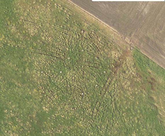

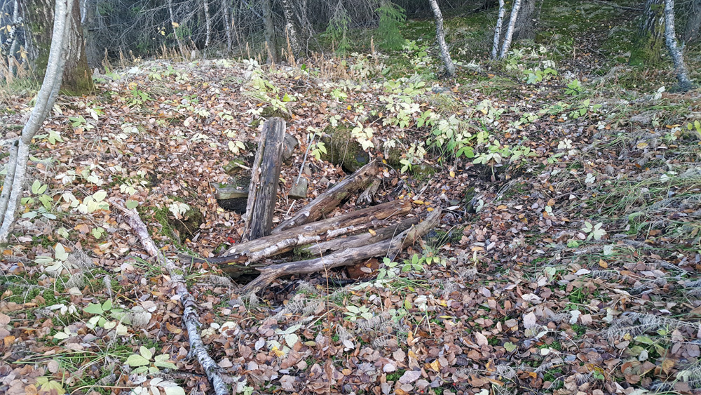

Finally I got the time to visit the area where Flusi Jensvold was located.
Not mutch to find, but there are some remains of a small building and some concrete with a pipe inside.
If this was related to the "Flusi".... I'm not 100% sure..

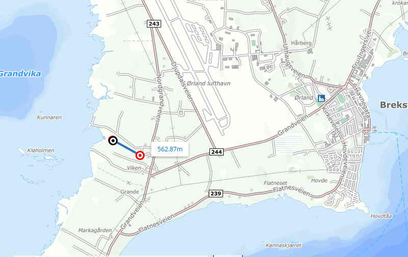

Tok en tur til Ørland Radio (mottakerstasjonen) på Grande idag.
Ca 500m VNV for dagens Ørland Radio ser det ut som det sto en installasjon. (flyfoto fra 1969)
Det var først i dag jeg fant fundamentene pga vegetasjon (gress).
På den ene stakk det opp en rest av coax-kabel. Det er 4 mastefester som står ca 15 fra hverandre. Hver mast er bardunert på 3 punkt. Festene står der fortsatt.
Jeg fikk ikke lokalisert midtpunktet mellom antennene, men det er i allefall ikke noe som stikker opp der.
Skal sjekke dette nærmere, men må ha med meg noe utstyr for å finne midten.
Jeg har ikke funnet noen andre bilder som kan vise hvordan dett sto før det ble revet.
Børge
Børge

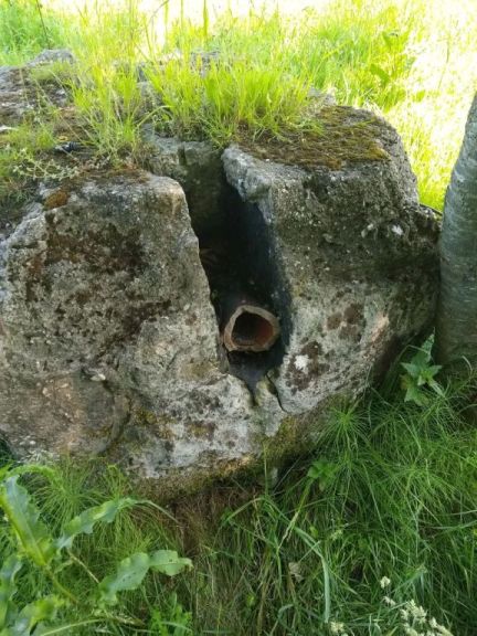

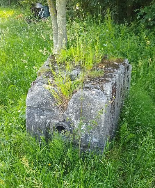

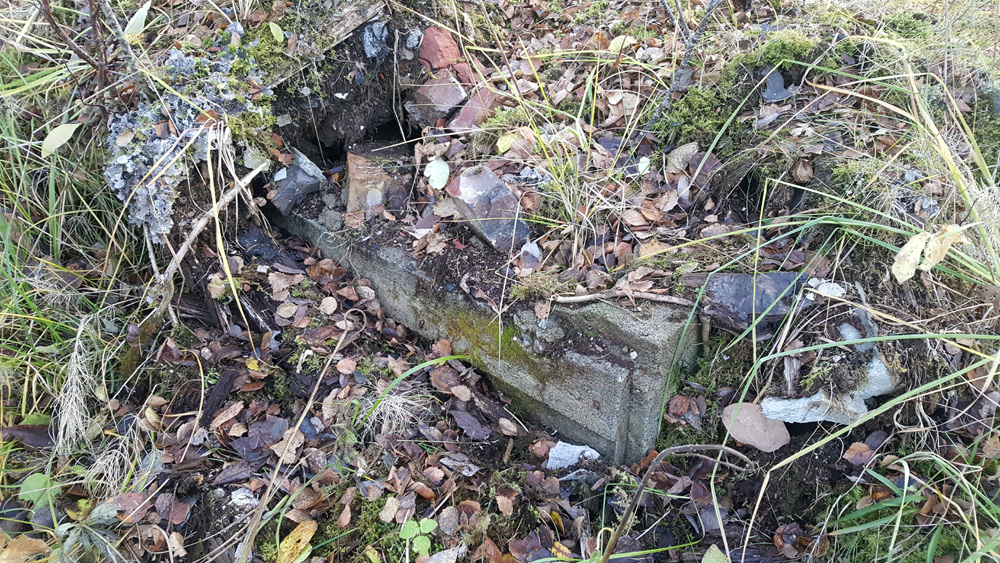

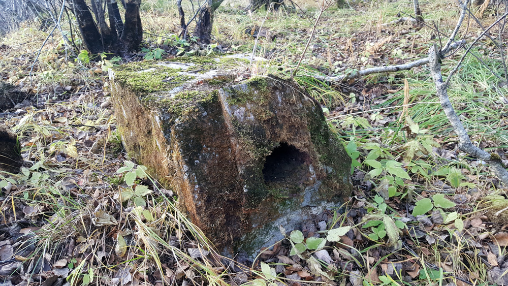

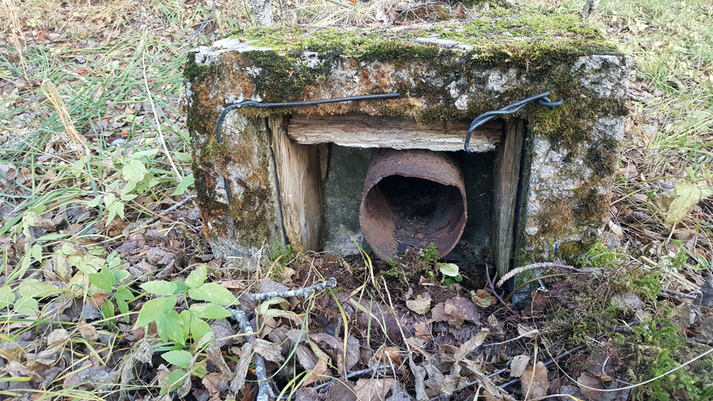

Hi!
For me, this is definitely a mast-socle of a Adcock-antenna!
Please see the attached socle-pictures of the remaining socle
of the longwave-A-50/A-60-Adcock-DF at German airfield Leck... Attached some measurements... Best wishes
Rolf

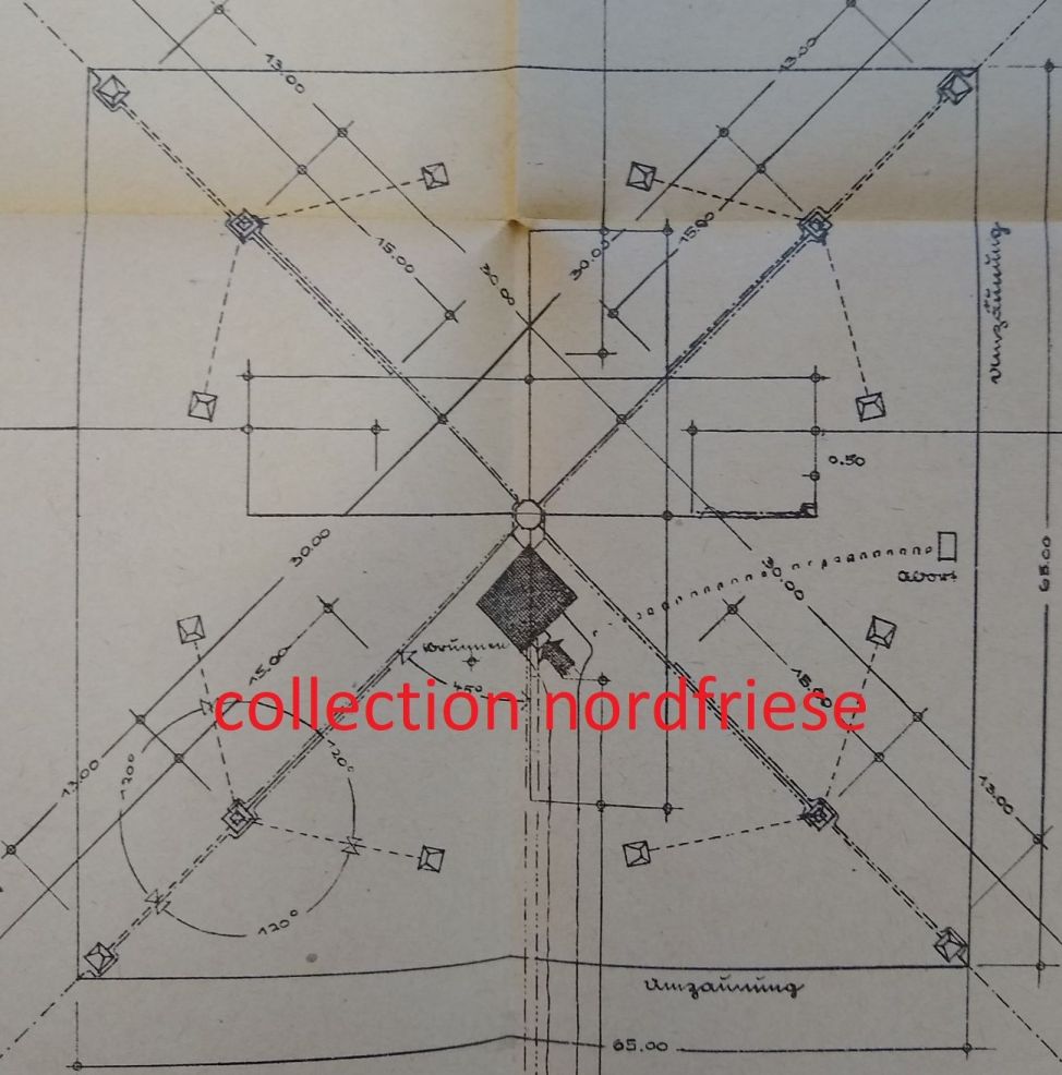

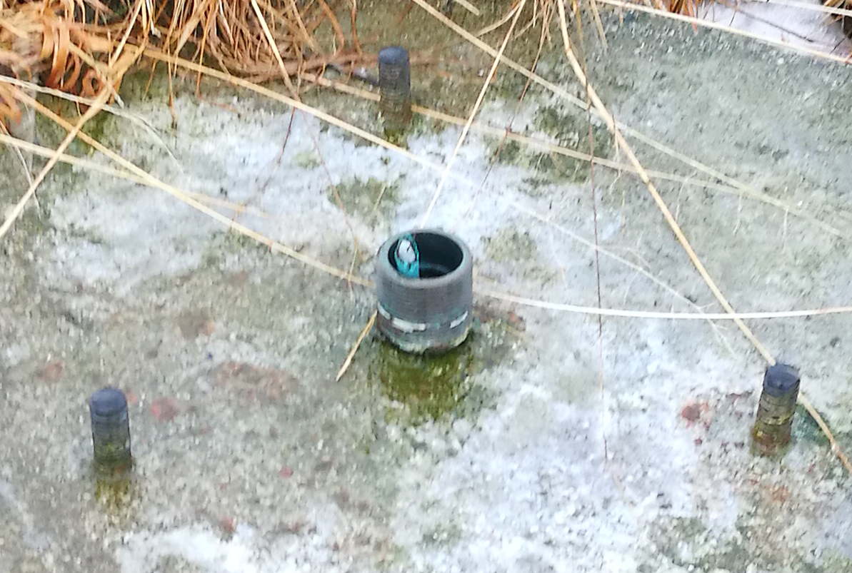

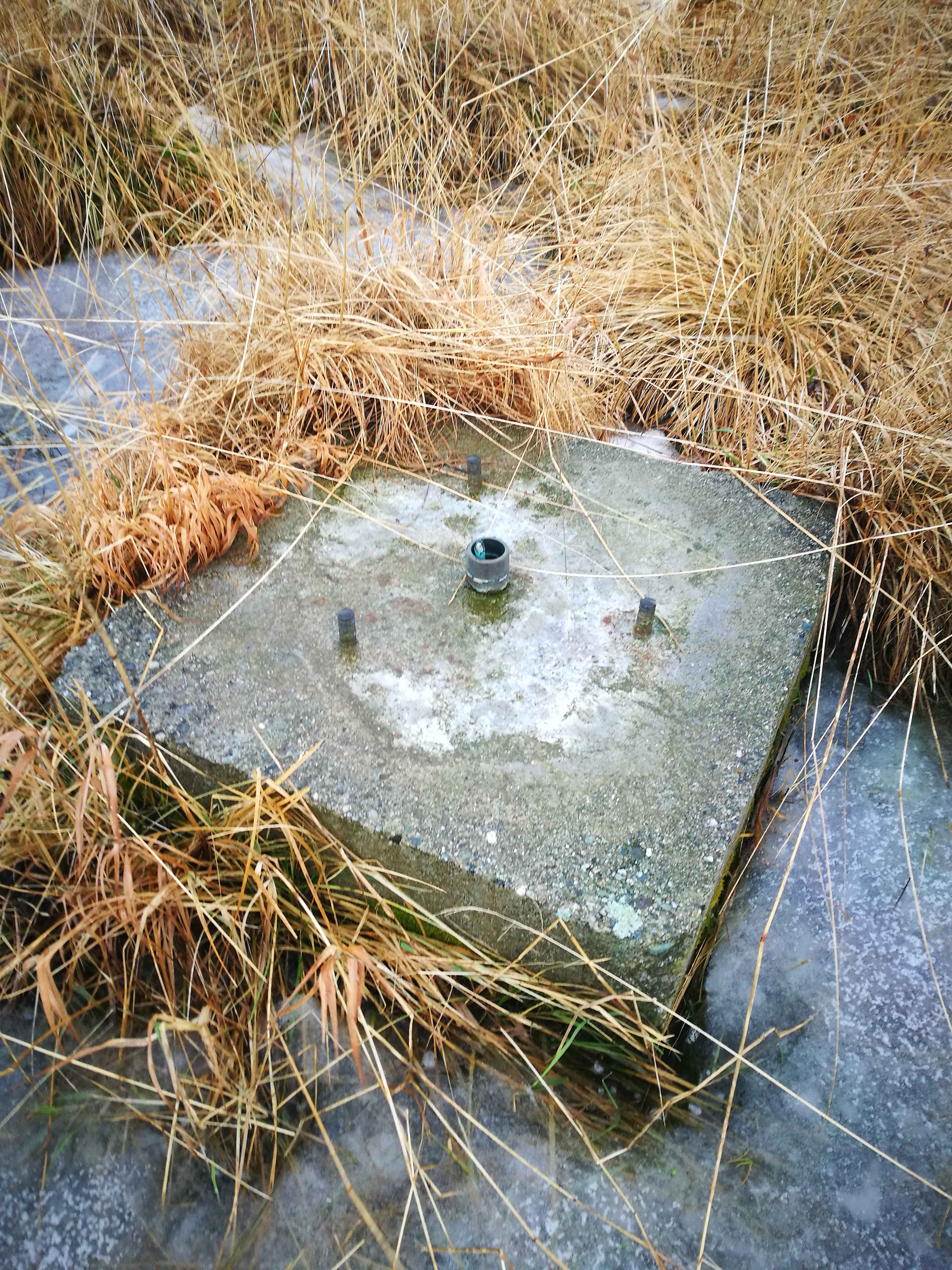

Some new information...Thomas L wrote:Flusi Jensvold...I'm not 100% sure..
Rolf
