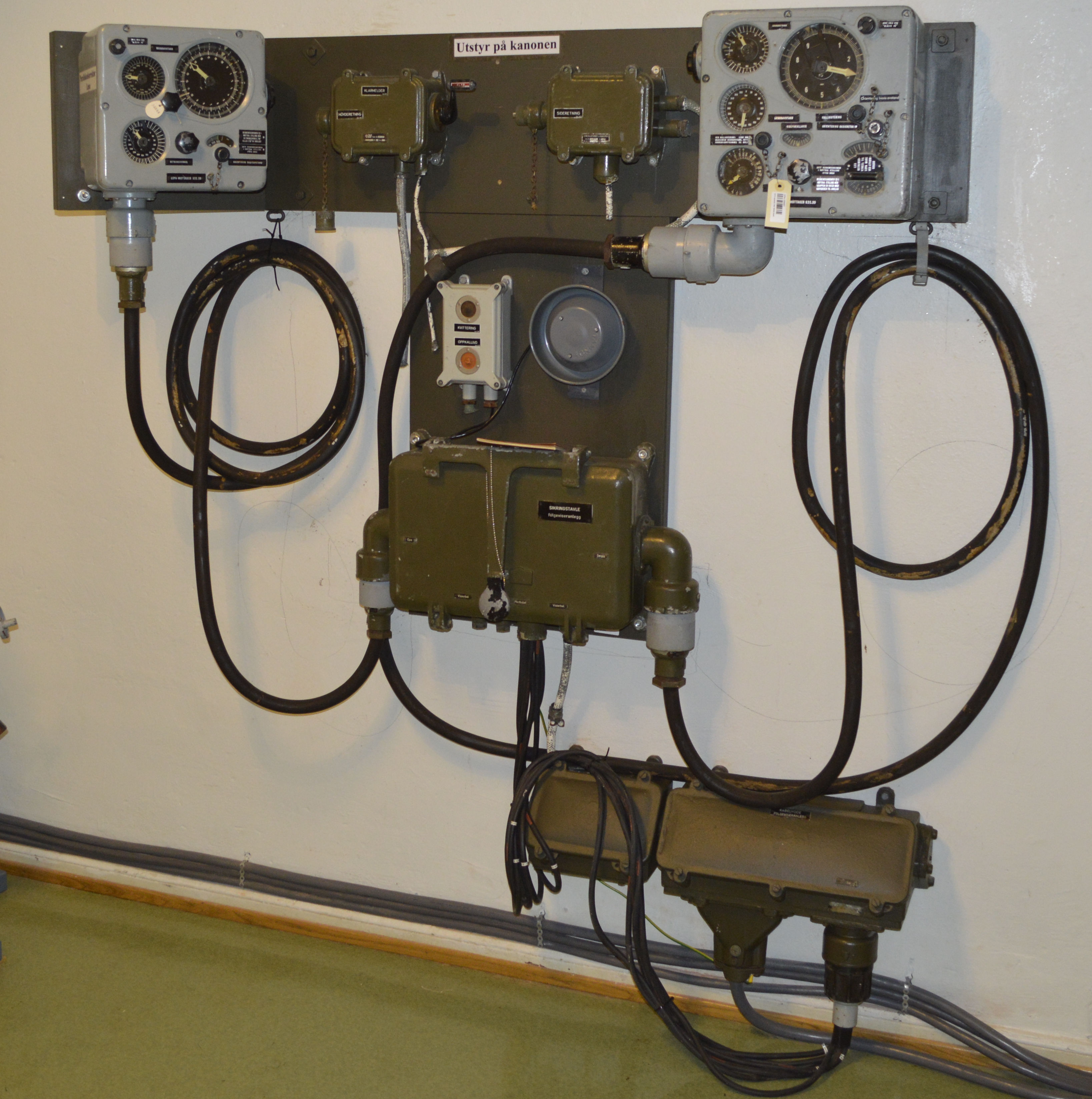

A picture of the gun equipment at Oscarsborg Fortress Museum
Re: Parts to ID
Posted: 14 Sep 2015 21:18
by jarecki71
Thank you very much for your help. Photo of a beautiful, I want a complete system:)
