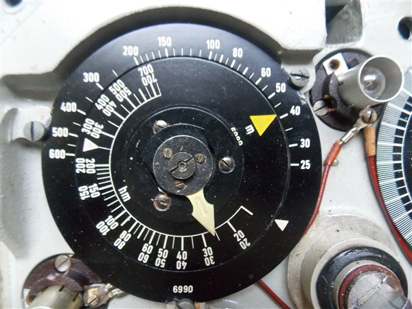

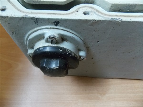

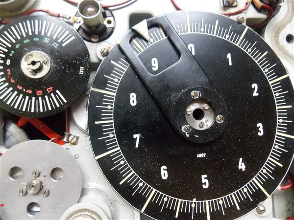

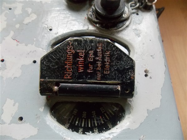

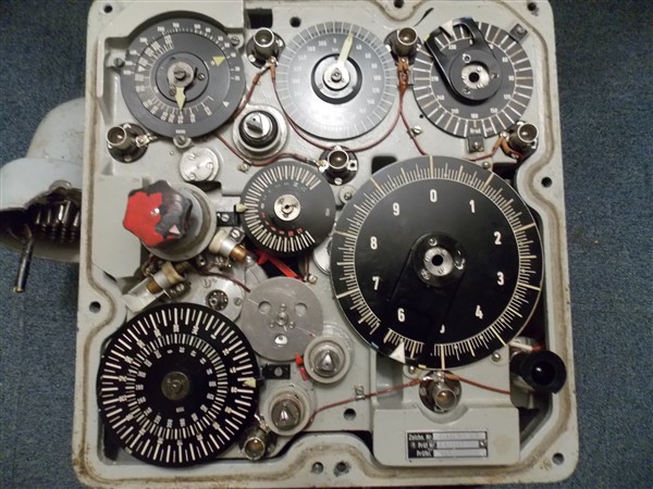

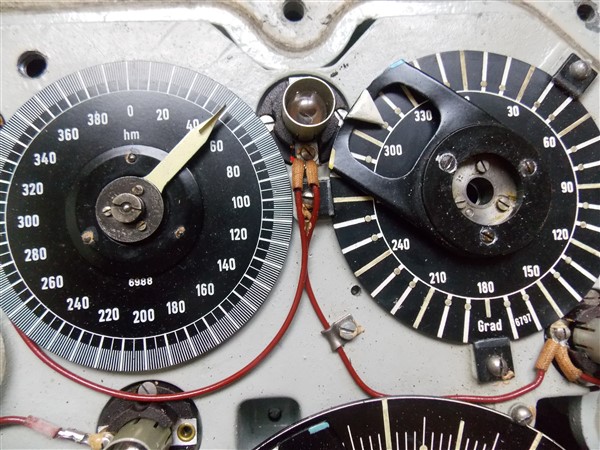

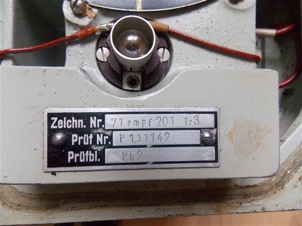

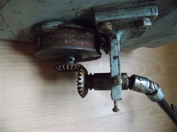

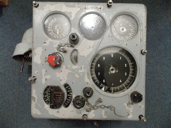

Hi all.
Please help in identifying the object below the pictures.
Other photos do not possess.
Thank you very much for your help.
Best regards,
Jarek
DSCN2291 (600 x 450).jpg (74.39 KiB) Viewed 14185 times
DSCN2294 (600 x 450).jpg (96.66 KiB) Viewed 14185 times
Azimuth receiver (gun side) of German Epa-Seipa Anlage C/39.

Thank you for your answer.
The device could work with guns, marine or coastal artillery caliber 15cm SK C/28, or larger?
At one pointers is a big adjustment 70 km?
Best regards,
Jarek
The picture is not good enough to determine if this is a 50V unit ( for guns with range 35000 meters or less) or if it is a 110V unit for superheavy coastal batteries.

.....some give you better pictures.
Best regards,
Jarek
PS
Interestingly, on a single disc is 380 hm, and the other 700 hm.
The Seipa receiver (Empfänger) is a 50V type, typically for 15 cm SKC/28 batteries.
In Norway we used this equipment as part of a "Fire Control system B" until the late 1970-ies. After that we used the instrument as a stand alone gun azimuth instrument until the end of the German gun era late 1990-ies.

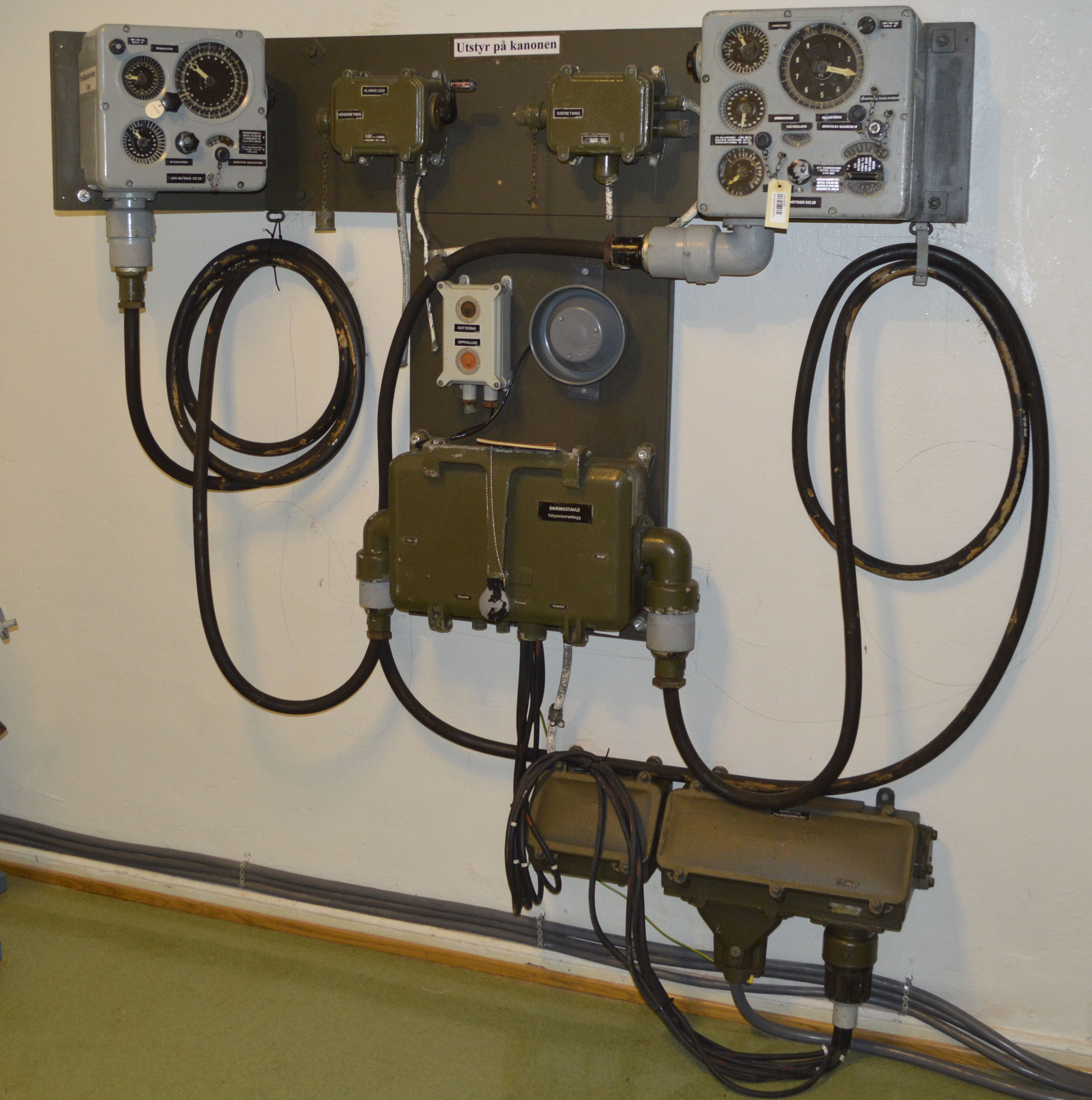

A picture of the gun equipment at Oscarsborg Fortress Museum
