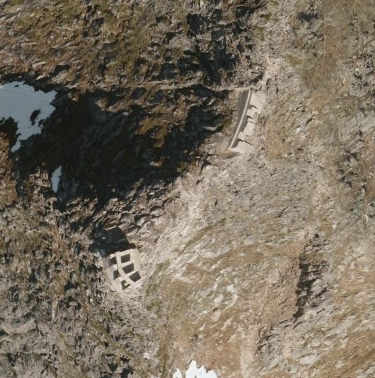

Some pictures, two from a norwegian hiking site and an aerial photo showing the foundations on the mountain Liatind

- Source: fjellforum.no
- Liatind.jpg (283.39 KiB) Viewed 3967 times
- Liatind2.jpg (590.65 KiB) Viewed 3967 times
- Liatind_NIB.JPG (83.16 KiB) Viewed 3967 times
In fact, one can find at 66°24'33"N 13°6'3"E the relicts of the basements of a lattice tower and at 66.42459 N 13.1668 E ( http://www.terraserver.com/view.asp?cx= ... .5&pic=img ) there is obviously an abandoned rock anchor.

That's way off (ref the models pictured in my previous post).Aldemarin wrote:In fact, one can find at 66°24'33"N 13°6'3"E the relicts of the basements of a lattice tower
That's about 30m from one of the three concrete installations on Liatinden shown on Tarjei's photo above.Aldemarin wrote:and at 66.42459 N 13.1668 E ( http://www.terraserver.com/view.asp?cx= ... .5&pic=img ) there is obviously an abandoned rock anchor.
I suspect you get your positions from a non-norwegian mapsite (for instance, Google Map positions are often 20-50m off)?
