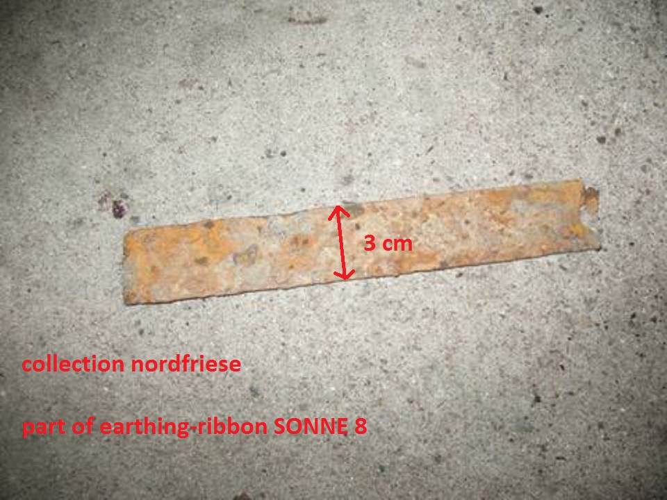

By the way... Here in Germany the "main-masts" of "Sonne" were just large wooden poles.
The lines between the "main-masts" were on simple telegraph-poles. Today there is
nothing left, just a few parts of the metal-earthing-ribbons on/in the fields.
