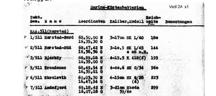

hallo!
Hat einer die Koordinaten dieser Batterie?
Bernd
Hello!
Are you sure that you got the number of this battery right?
I can not find a battery with that number (4/511) in my listings. Number 4 seems to not exsist in MAA 511.
Regards, Sigfred R.
Listing HSD 1945.<br />(Røsok/Andersen)

Hello!
So when the atlantic wall-research-norway.de this position is given. MKB 4 / 511 Ofoten from 1941-1944.
Bernd

RasmusTerne wrote:MKB 4/511 was a railway battery, and as sutch there will be no remains in the Ofoten area.
See also. http://www.kystfort.com/forum/topic1638-15.html
There are several bunkers and flak-posistions at the battery's location in Nærbø, so I assume there might have been similar constructions at the Ofoten-site (maybe not relevant, but it was located in Ofoten for a longer period than in Nærbø...)?

Hello!
I am still not so sure that one will find any remains in Narvik connected to this battery. The railway runs right thru the center of the city, and ends on Framnes, the storing and shipping area for iron ore from Sweden. In my opinion this (Framnes) is the most likely posision for placing a battery against sea targets in Ofotfjorden, and in this area there is absolutly nothing left of what might have been there in -45.
Regardinf AA battery and other sites was the Narvik peninsula and the areas surrounding the city "crowded" with them.
If the instalations of MKB 4/511 was sited between the railway station and Bjørnefjell we have a "case" :) It might just be something left there.
Regards Sigfred R.
