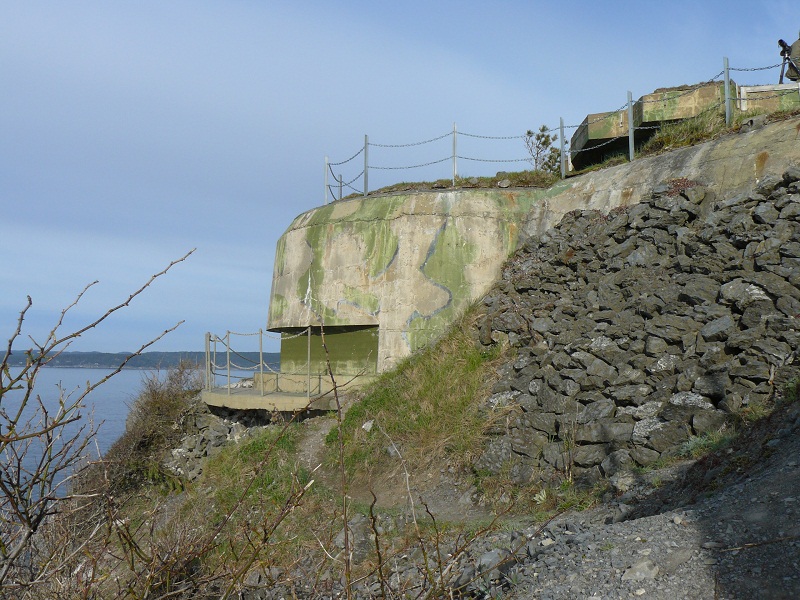

Kanon II:
Kanon III:
Kanon I:

Kanon II:
Kanon III:
Kanon I:
