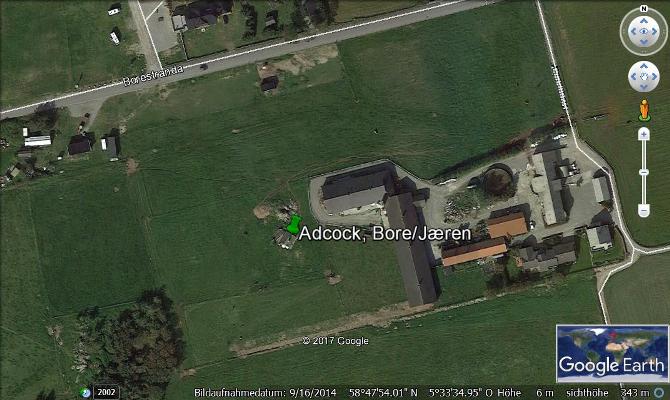

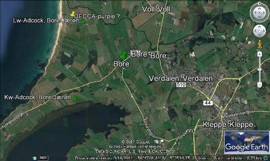

After I read the notes of Erik E and TØ about the DF at Bore/Hodne,
I took a look at this area at Norgeibilder.
A list of Adcocks in Norway says, the Germans had in Bore-area a
Shortwave-DF and a Longwave-DF both for "Flugsicherung" (air
traffic control).
I found the shortwave-DF-hut in Hodne-area quite easy at the pictures
of 1960 (Thank you, TØ, for the information about Hodne!).
North of the position, I found a "antenna" which looks to me like a
longwave-Adcock. The main hut is still there today.
- Adcock Bore LW 1960 norgeibilder.jpg (44.57 KiB) Viewed 15039 times
- Adcock Bore LW today.jpg (54.53 KiB) Viewed 15039 times
- Adcock Bore LW-Hut.jpg (89.49 KiB) Viewed 15039 times
360 m northwest of the "LW-Adcock" was a huge single mast in 1960.
I'm not sure, but as far as I know, there was a DECCA-station in this
area for navigation in post-war-times. I think this mast was the DECCA-
station.
- DECCA-purple Bore 1960 norgeibilder.jpg (36.05 KiB) Viewed 15039 times
My question:
Was the large "four-mast-post" a German-longwave-Adcock, which was used by Norway after the war
or does this post belong to the "DECCA-mast"?
Source of the b/w-pictures:
http://www.norgeibilder.no/
Thanks in advice
Best wishes
Rolf

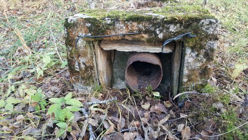

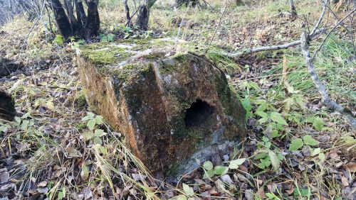

Finally I got the time to visit the area where Flusi Jensvold was located.
Not mutch to find, but there are some remains of a small building and some concrete with a pipe inside.
If this was related to the "Flusi".... I'm not 100% sure..

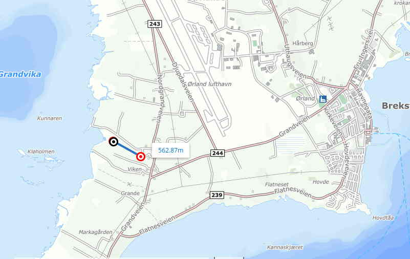

Posted: 26 Jan 2018 17:39
by borge.mohus

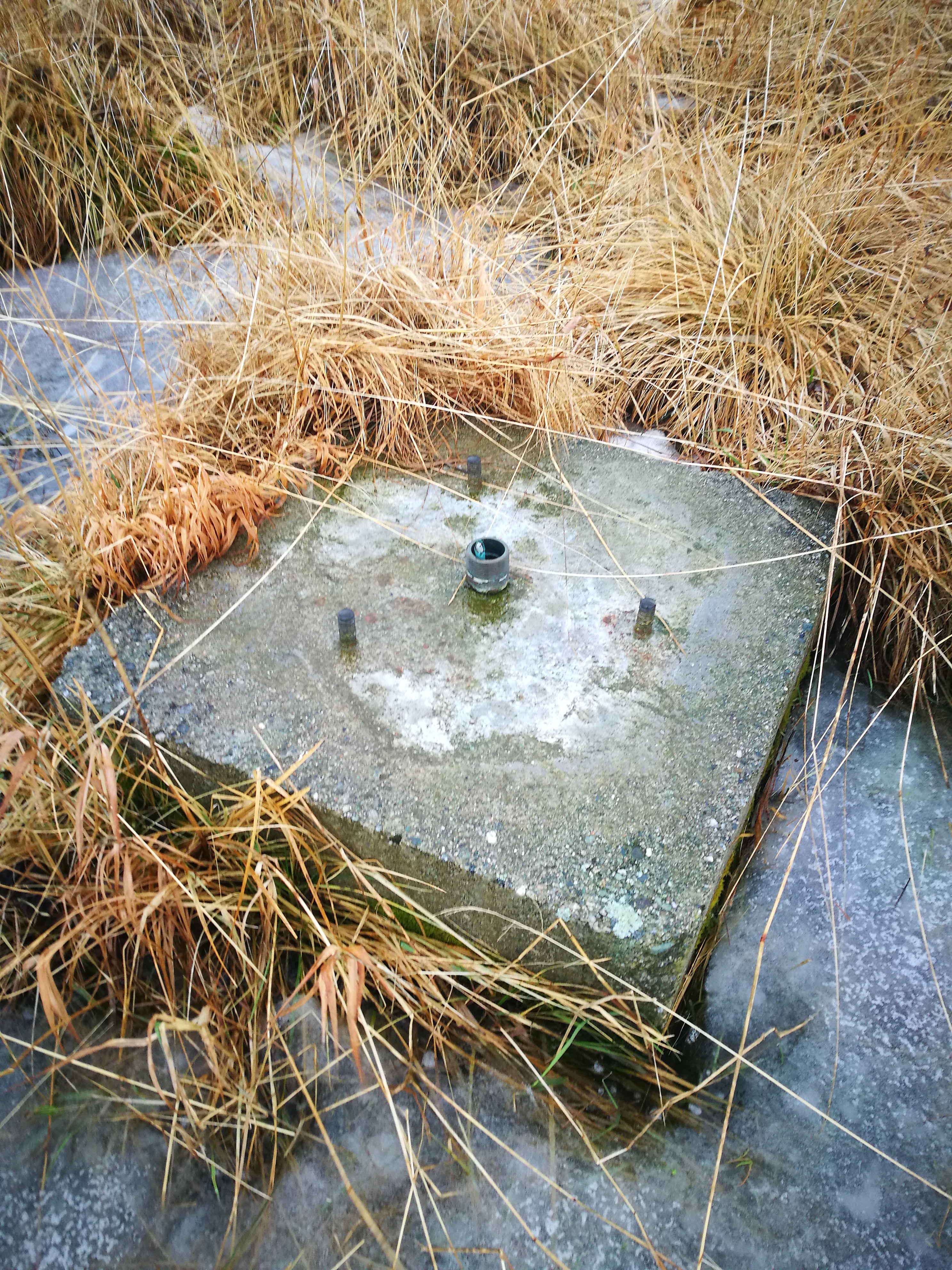

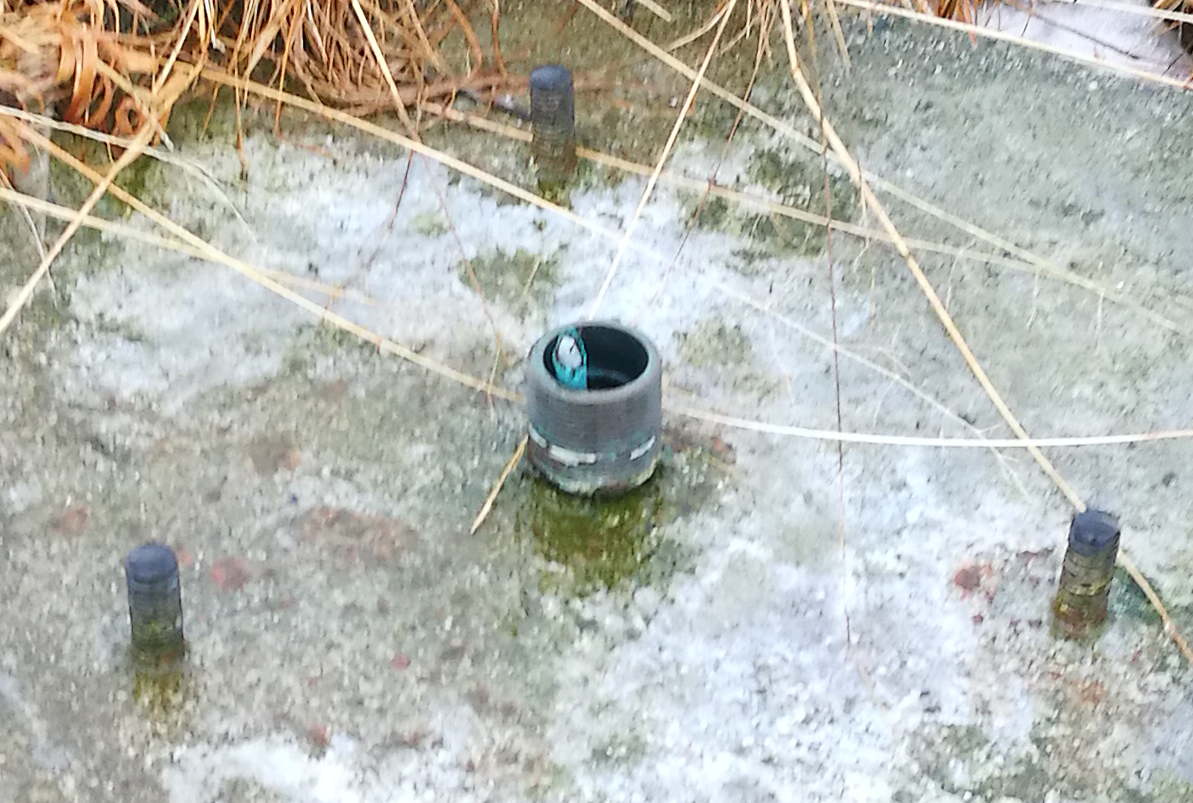

Tok en tur til Ørland Radio (mottakerstasjonen) på Grande idag.
- flyfoto 1969
- Screenshot from 2018-01-26 16-05-05.png (200.95 KiB) Viewed 14942 times
- flyfoto 2017
- Screenshot from 2018-01-26 16-06-14.png (446.89 KiB) Viewed 14942 times
- Lokasjonen er det vestligste punktet
- Screenshot from 2018-01-26 16-12-23_c.jpg (43.59 KiB) Viewed 14942 times
Ca 500m VNV for dagens Ørland Radio ser det ut som det sto en installasjon. (flyfoto fra 1969)
Det var først i dag jeg fant fundamentene pga vegetasjon (gress).
På den ene stakk det opp en rest av coax-kabel.
- Fundament
- IMG_20180126_120229_50c.jpg (136.98 KiB) Viewed 14942 times
- Fundament
- IMG_20180126_120229_20.jpg (1.32 MiB) Viewed 14942 times
Det er 4 mastefester som står ca 15 fra hverandre. Hver mast er bardunert på 3 punkt. Festene står der fortsatt.
Jeg fikk ikke lokalisert midtpunktet mellom antennene, men det er i allefall ikke noe som stikker opp der.
Skal sjekke dette nærmere, men må ha med meg noe utstyr for å finne midten.
Jeg har ikke funnet noen andre bilder som kan vise hvordan dett sto før det ble revet.
Børge

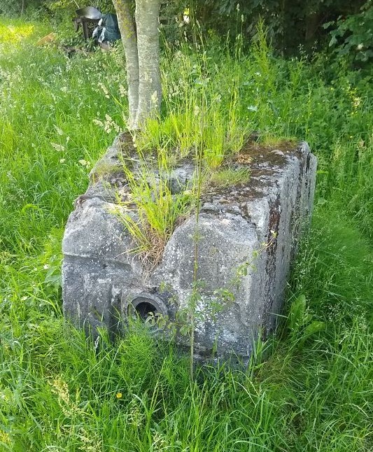

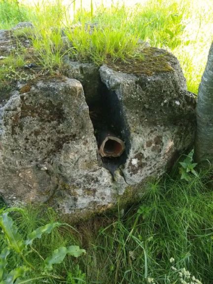

Posted: 23 Jun 2019 12:14
by nordfriese
Hi!
Thomas L wrote:Flusi Jensvold...I'm not 100% sure..
- Bodø (3).jpg (72.57 KiB) Viewed 14873 times
- Bodø (4).jpg (69.18 KiB) Viewed 14873 times
Some new information...
For me, this is definitely a mast-socle of a Adcock-antenna!
Please see the attached socle-pictures of the remaining socle
of the longwave-A-50/A-60-Adcock-DF at German airfield Leck...
- Adcock-antenna-socle Leck - Top.jpg (228.13 KiB) Viewed 14873 times
- Adcock-antenna-socle Leck - Bottom.jpg (92.58 KiB) Viewed 14873 times

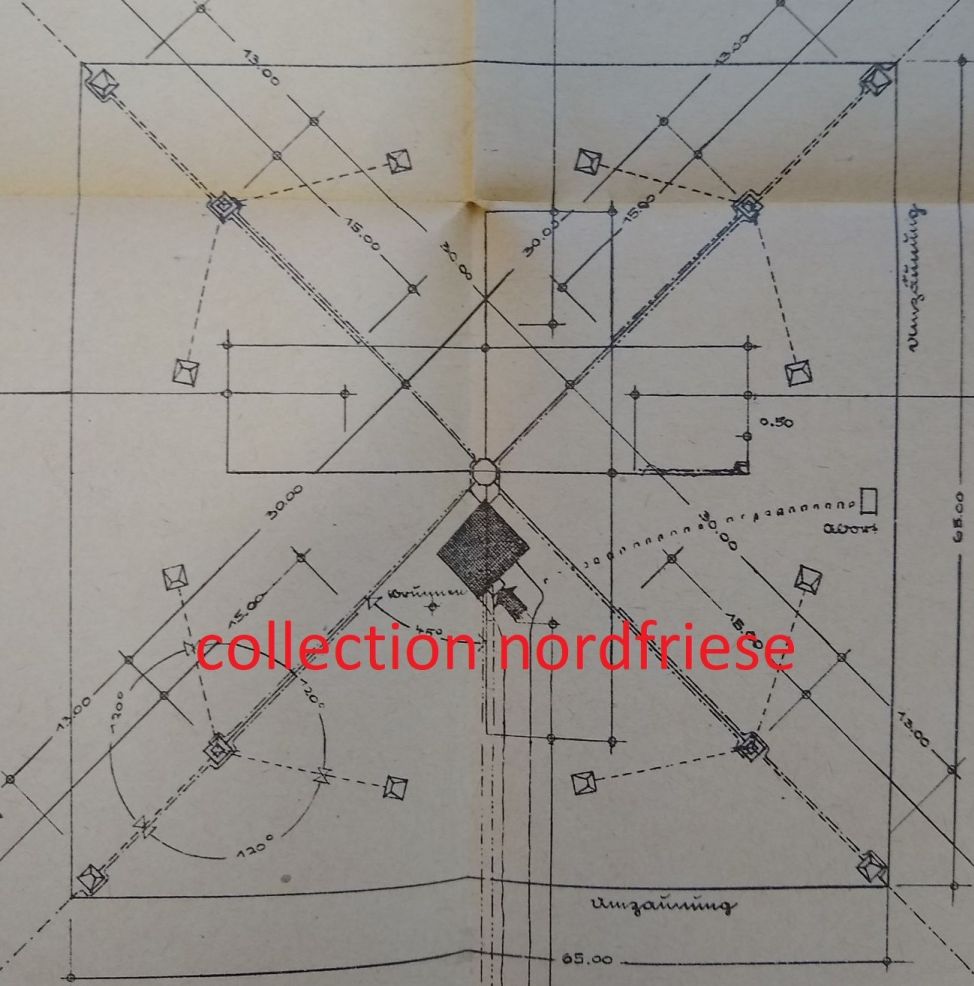

Attached some measurements...
- Adcock A50-A60.jpg (139.54 KiB) Viewed 14873 times
Best wishes
Rolf
