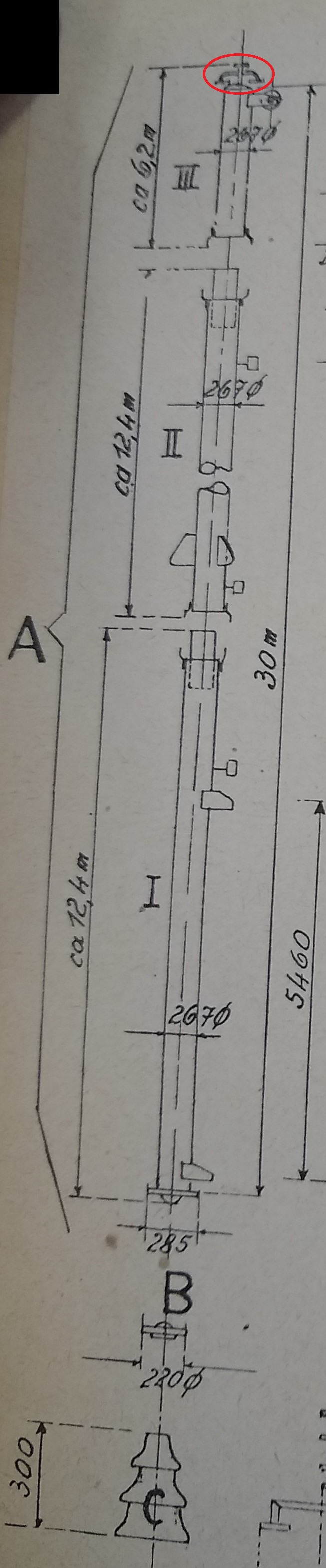

Hei!
borge.mohus wrote:En liten detalj fra toppen av mastene som ligger på Ørlandet
Have you measured the part of the antenna you have found?
FuPeilAnl A50-A60 (4).jpg (612.57 KiB) Viewed 7613 times
Best wishes
Rolf

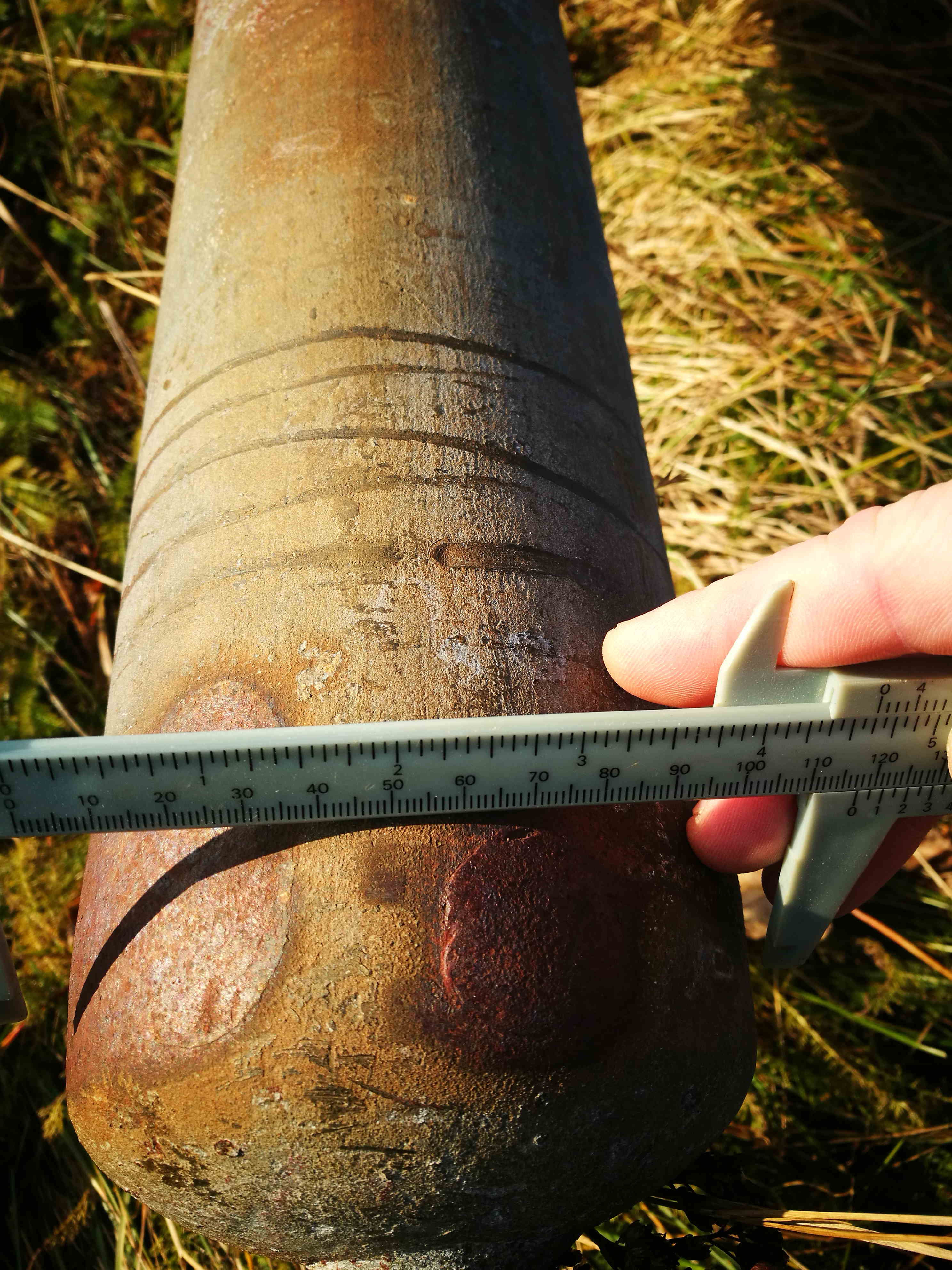

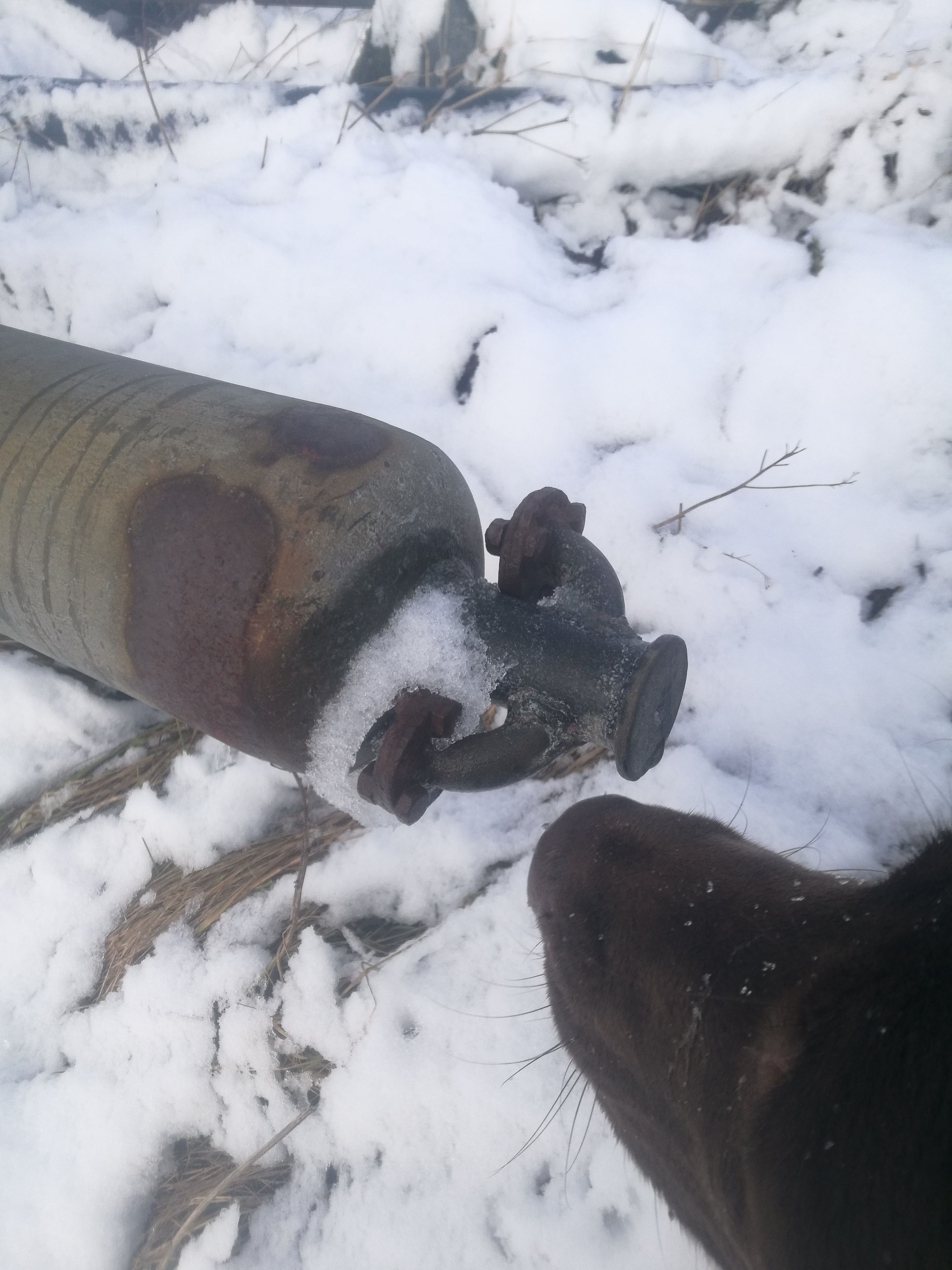

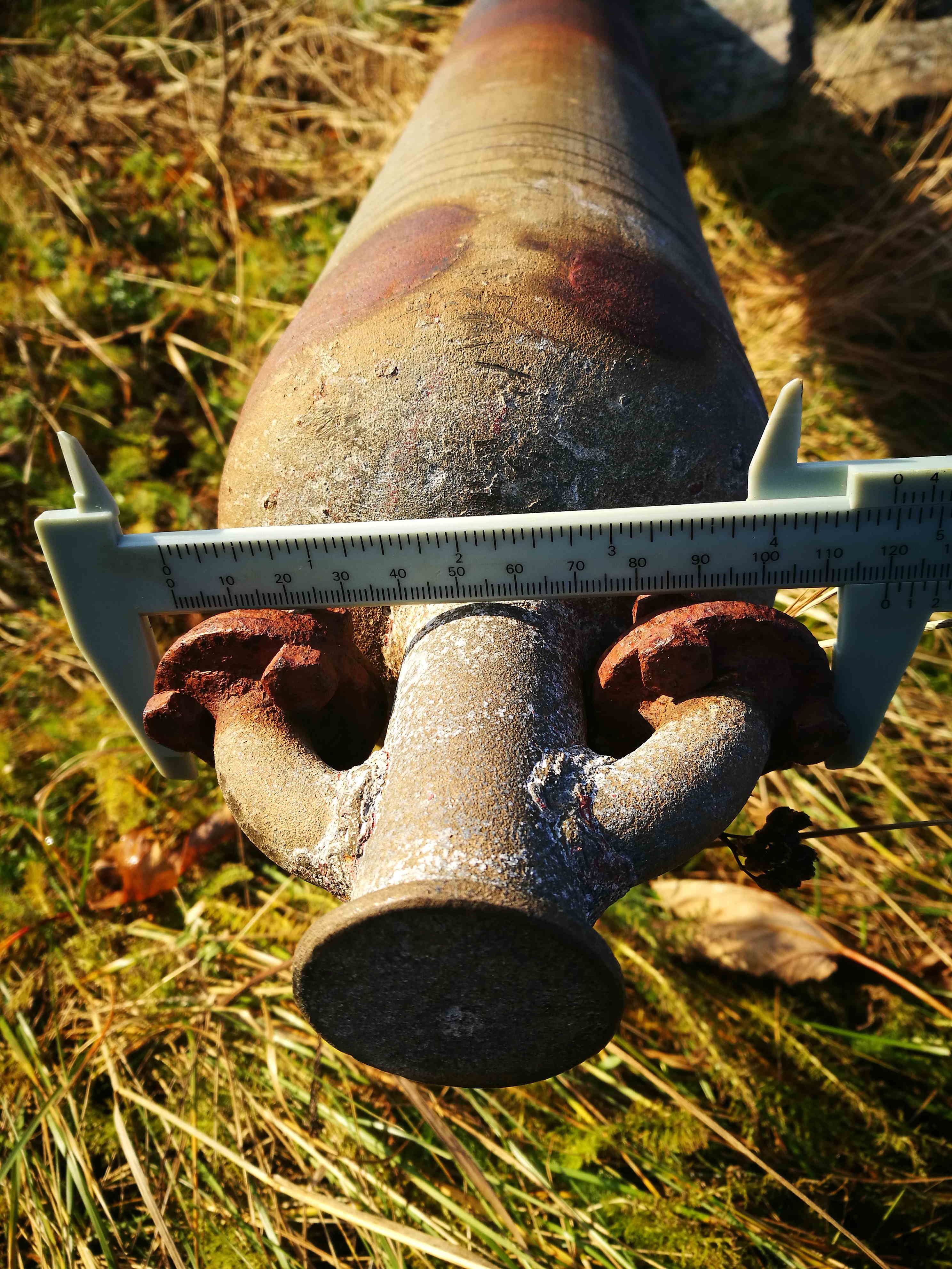

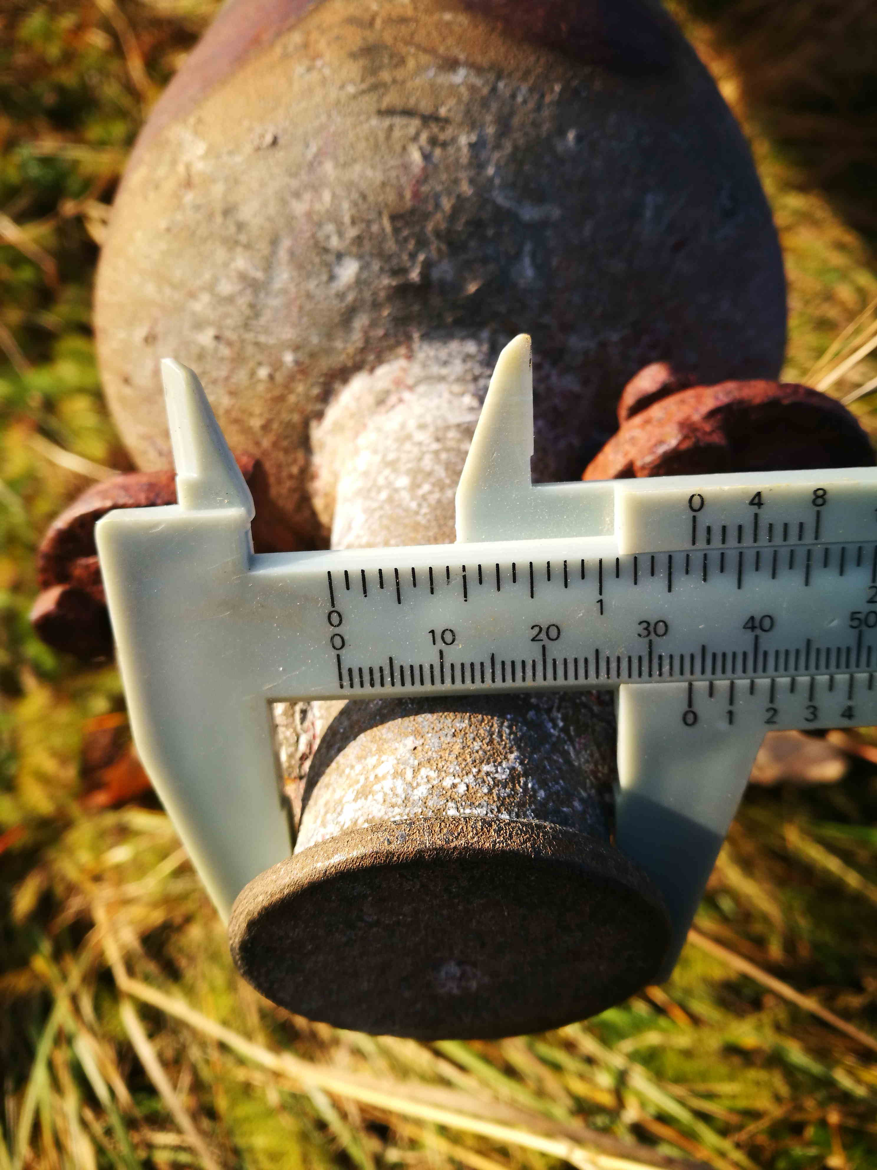

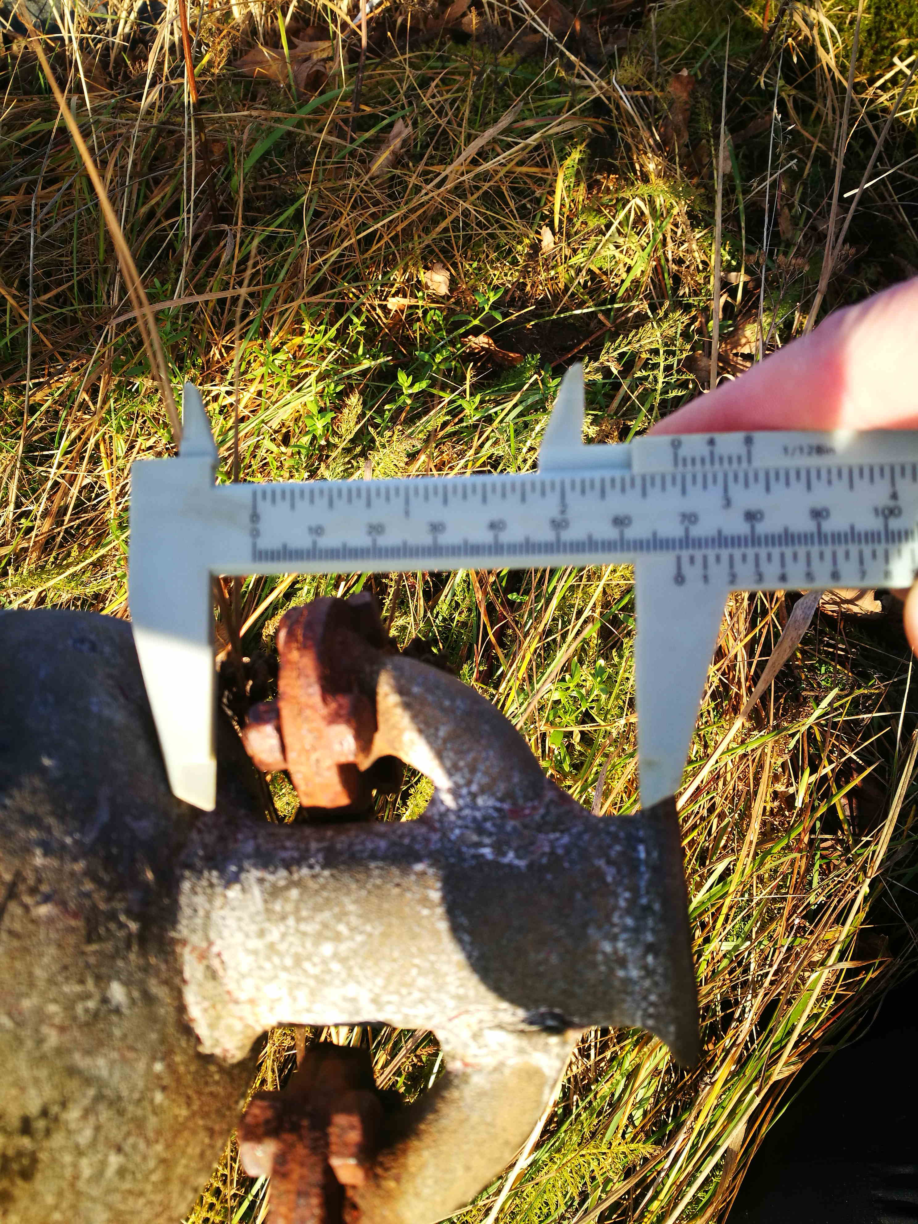

Re: Spørsmål ang. MPHS Stavanger.
Posted: 02 Nov 2019 16:32
by borge.mohus
Hi Rolf.
The total length is about 11m
Some details in the pictures
BR Børge
ø34
ø34
L~70
L~70
ø~120
ø~120
w~120
w~120
Posted: 08 Dec 2019 15:19
by nordfriese
Hei!
Sorry for the late reply...
Thanks a lot! :-D
Could have been a A 40 f "Stettin A" (4-mast-Adcock-DF).
The Luftwaffe had two Adcock-DFs, which were 11m long,
but the other one had a different top.
Best wishes
Rolf
