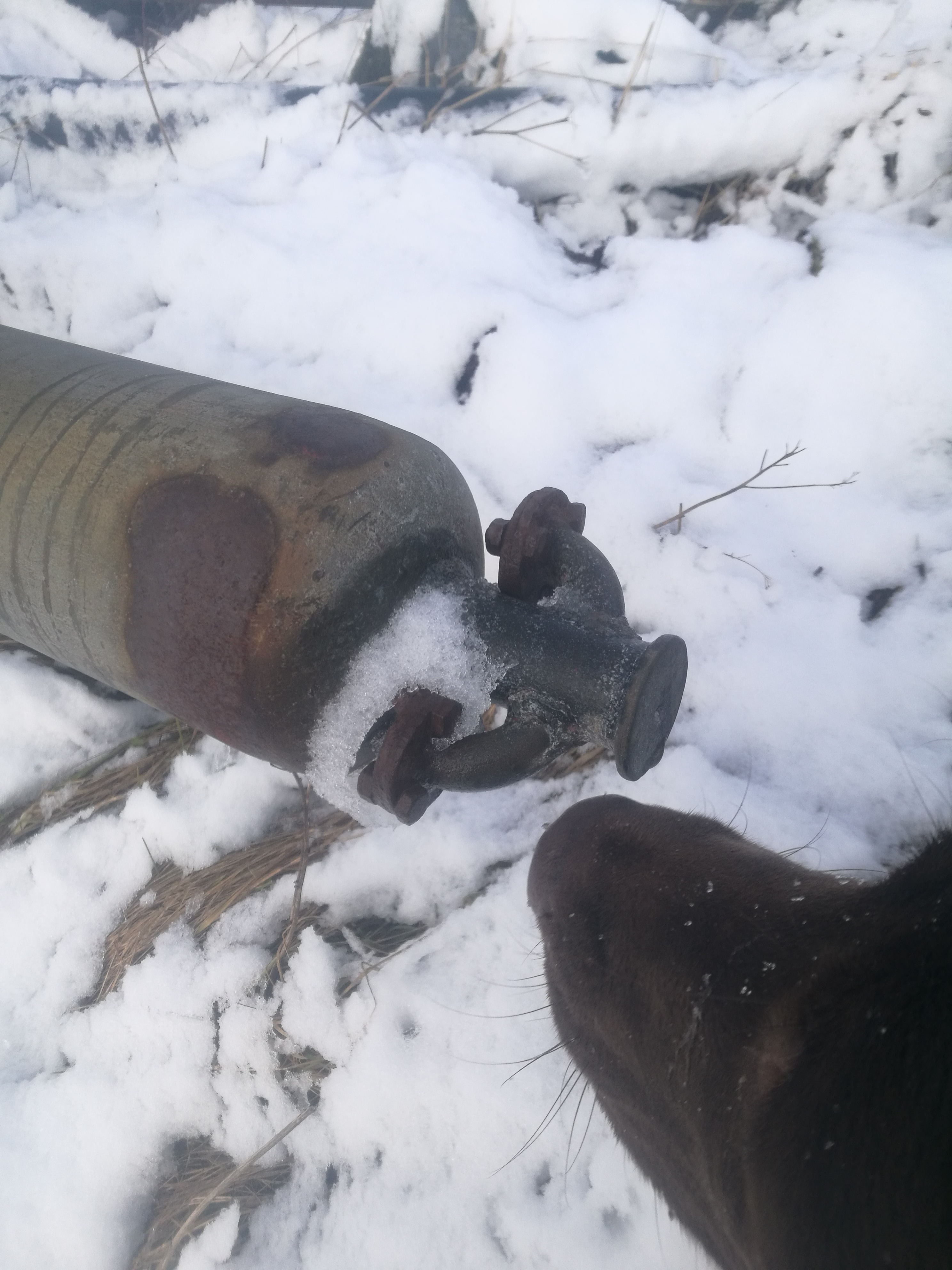

borge.mohus wrote:En liten detalj fra toppen av mastene som ligger på Ørlandet
Have you measured the part of the antenna you have found?

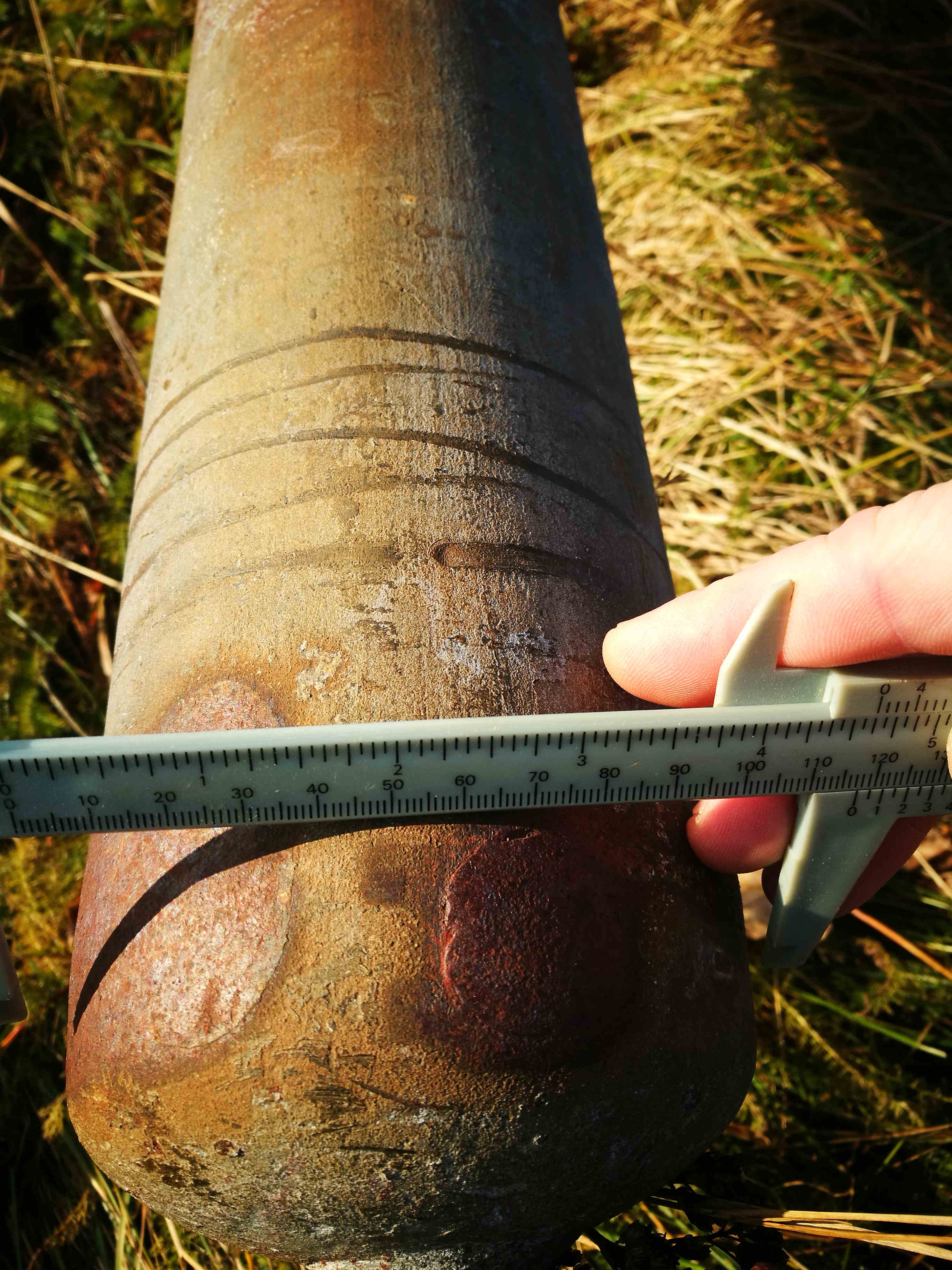

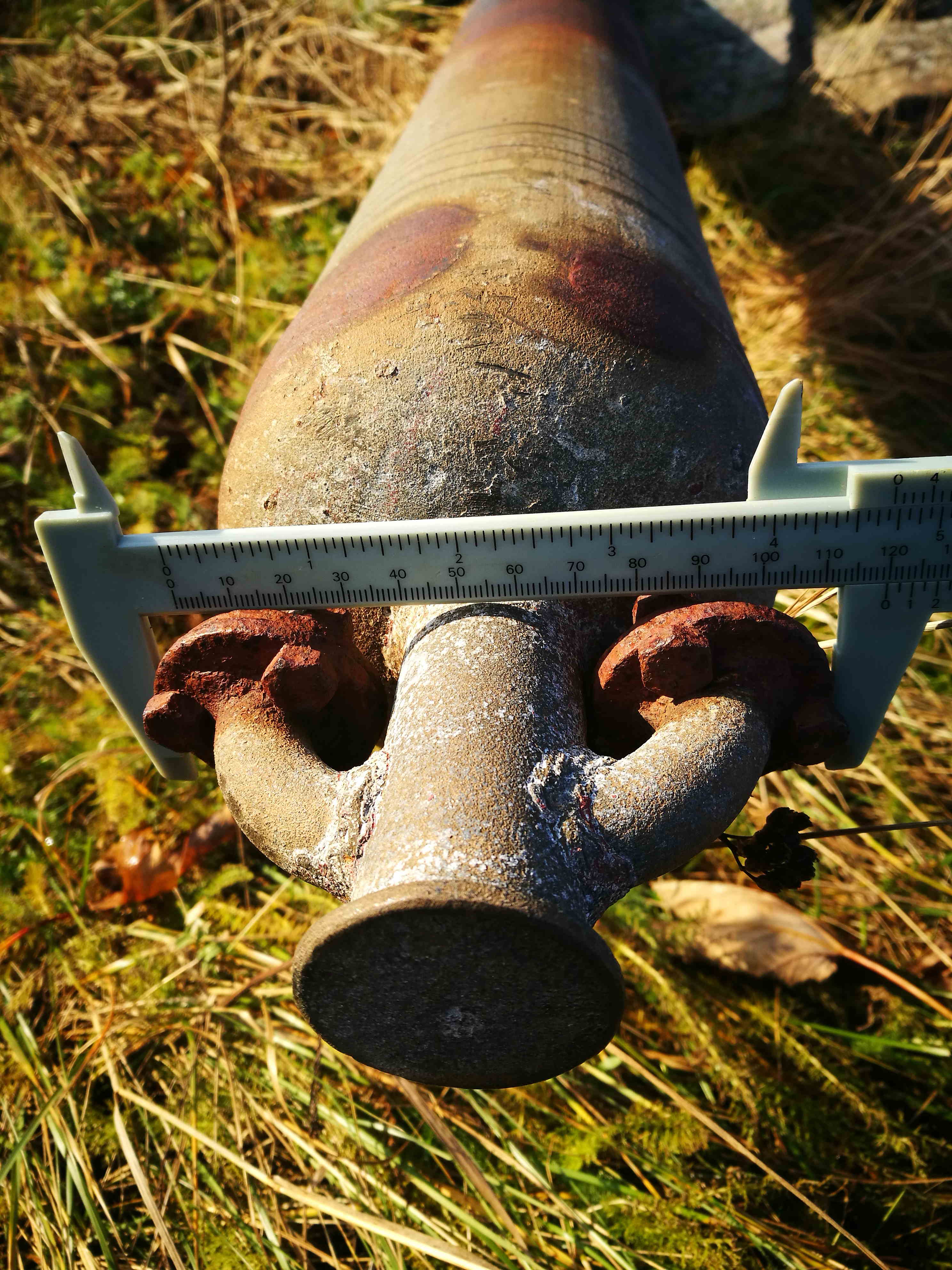

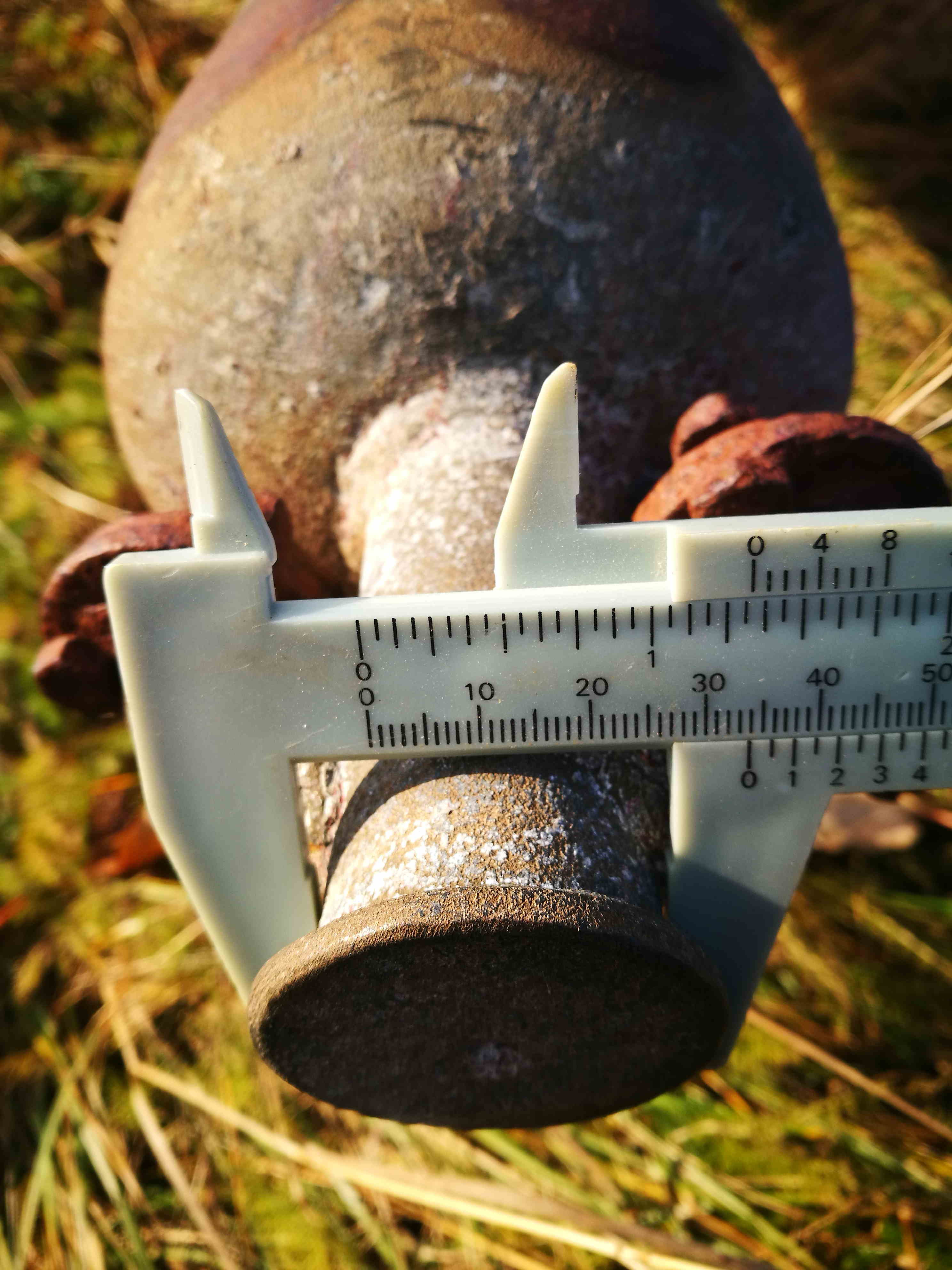

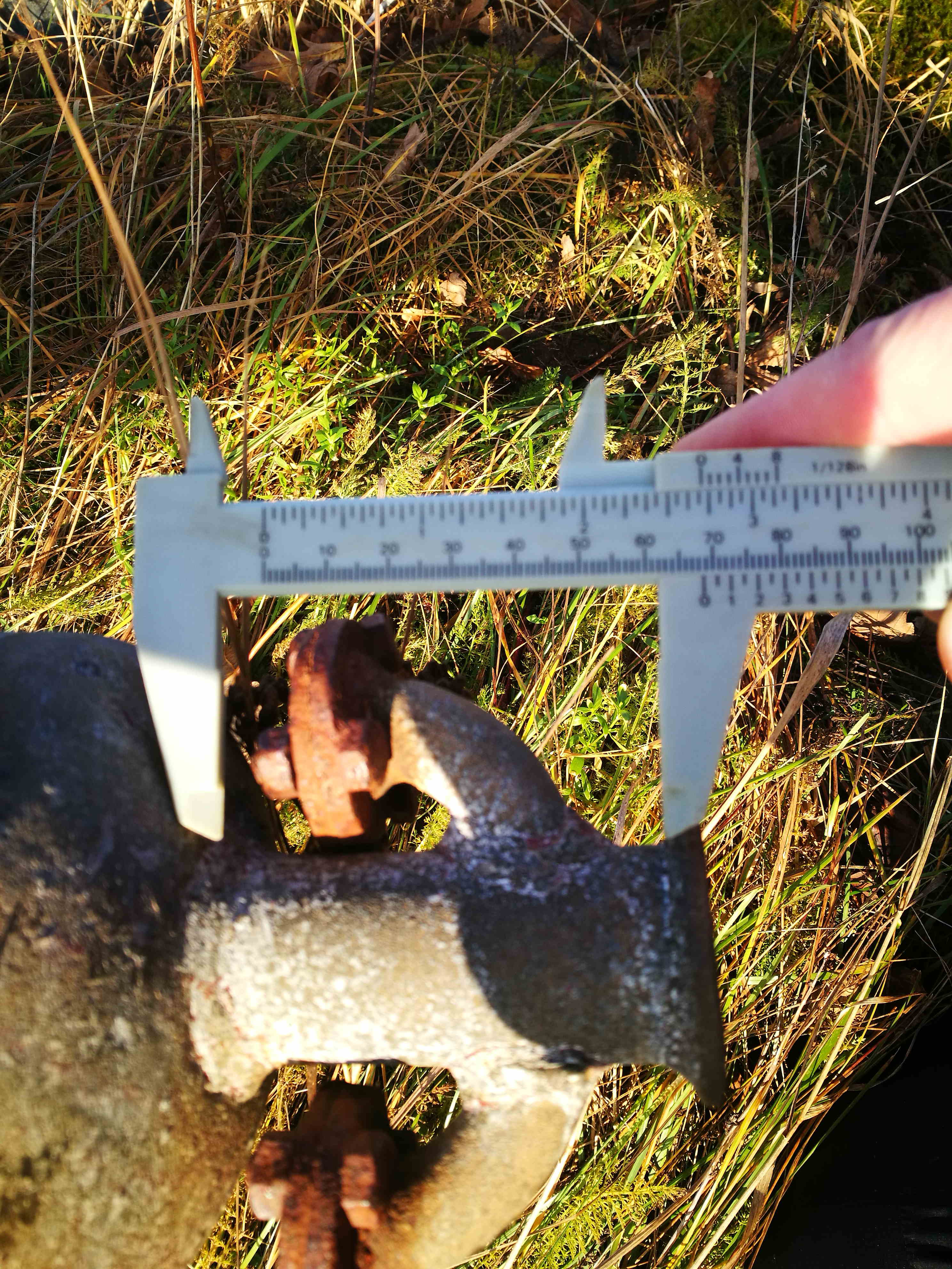

Hi Rolf.
The total length is about 11m
Some details in the pictures
BR Børge
ø34
ø34
L~70
L~70
ø~120
ø~120
w~120
w~120

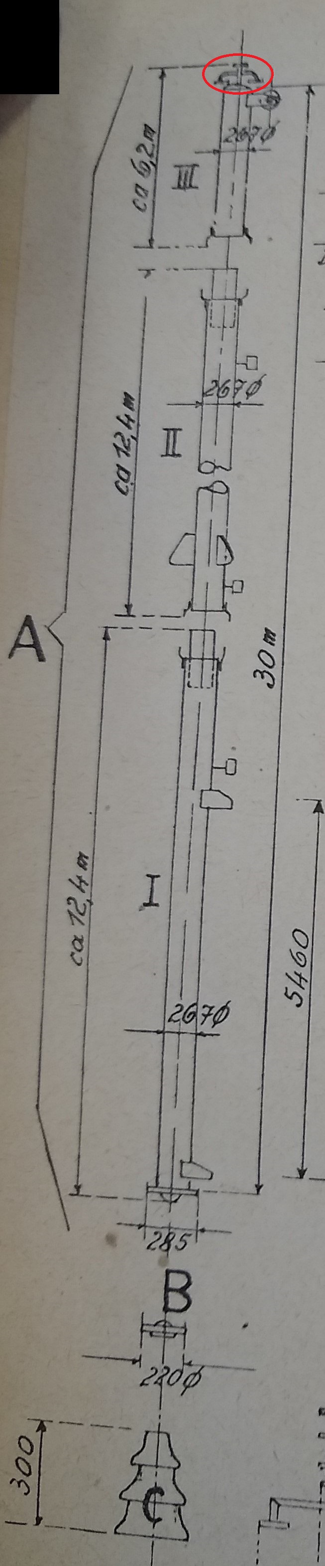

nordfriese
Posts: 70
Joined: 03 May 2013 22:30
Location: Bredstedt/Tyskland
Hei!
Sorry for the late reply...
Thanks a lot! :-D
Could have been a A 40 f "Stettin A" (4-mast-Adcock-DF).
The Luftwaffe had two Adcock-DFs, which were 11m long,
but the other one had a different top.
Best wishes
